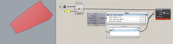

I try to add floor in Revit with a simple closed and planar crv but with no luck.
I wonder why … did I miss something?
Thanks
Add Floor.gh (17.9 KB)

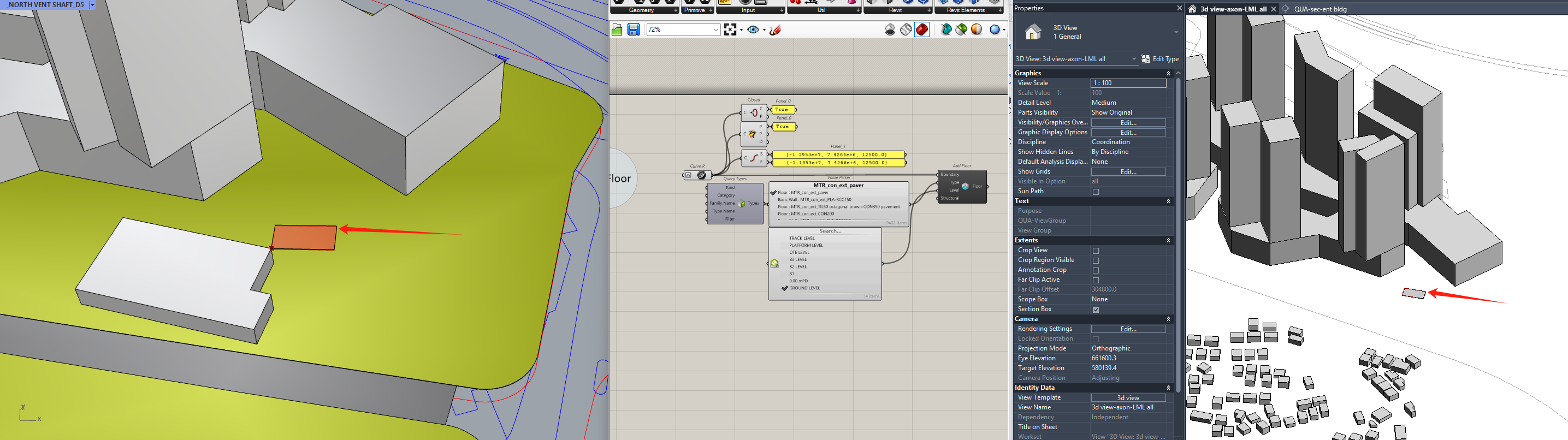

This curve is too far from the origin… Moving it near the origin will make it work properly.
Is there an alternative way? I cannot move the crv to other place cos this is the project location…Can I change the origin instead? If I change the origin, can I maintain the project coordinates no change?
I use a simple rectangle but it works…can I assume that this is not the issue of the origin location?
Try to use the Fit Curve to achieve it,
I see, many thanks!
