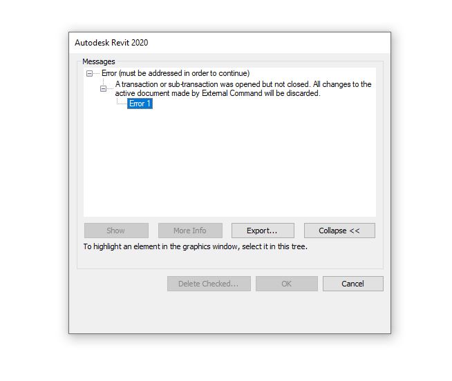

Hi @eirannejad,
I tried your script and its work within your example file, but when I tried to copy the Phyton Node (Align Instance) to my file, Its does not work and gave me an error.
The instance(s) actually not out side of the host. its still in the host family.
Thank You.
