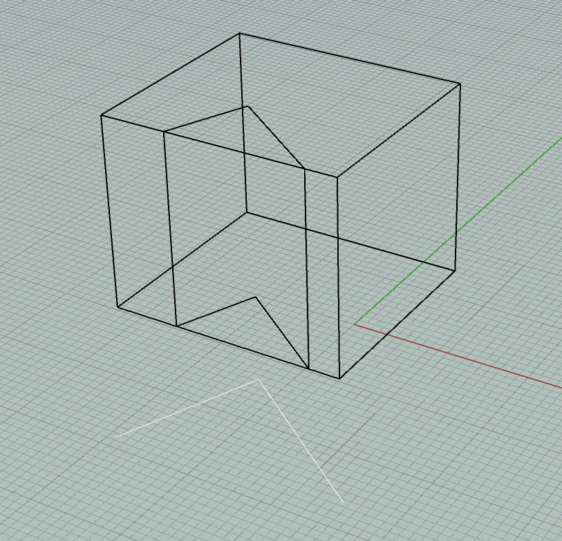

It’s a simple cube with a cut-out of a 30 degree turned cube. So yeah pretty easy boolean task i guessed, since I’ve worked with 3D Max before. But since i cut out only half of this other cube it doesn’t work with Boolean (hard to explain but that is not the point anyway).
What really would help me is to just add 2 lines on the cube. Like adding an edge on an face to intrude those new faces I create by adding the lines on the face.

Well, I would suggest looking into this some more because that really shouldn’t be a problem. Could you post the model?
At any rate, you can draw a closed polyline on one surface and split that surface with the polyline, giving you the edges you are looking for.

You don’t have to draw your cutting lines on the surface. I elevated a box above the CPlane in the “perspective” view, and drew the (white) lines on the CPlane. Yet the “split” command resulted in the box being split orthogonally above those cutting lines.
The same can be done in the “right” or “front” views, with the vertically oriented CPlanes.
Max.
btw, “boolean difference” is perfectly suited for this kind of operation, but you have to make sure that both of your cubes are solids. If you did not draw them as solids in the first place (the “box” command, or extruding a closed curve with the “ExtrudeCrv” command ), you can still create solids by joining all surfaces that make up the cube.
