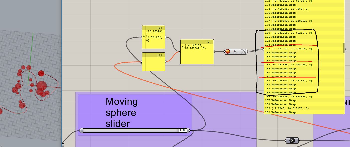

maybe you can use data recorder and you move the point manually and slowly.
as you see in the image when the sphere intersect with 3 trees you will see the point above them
i don’t know if there is a method to make the point moved automatically than you need to split the data result to find the maximum amount of the word Referenced Brep and their points
I’m not sure I understand what you wrote,
could you explain it again?
it’s just an idea ; when you move the sphere manually data recorder will record where the sphere intersect with the trees
than you can find the moment or the position where the sphere intersects with the biggest amount of trees
