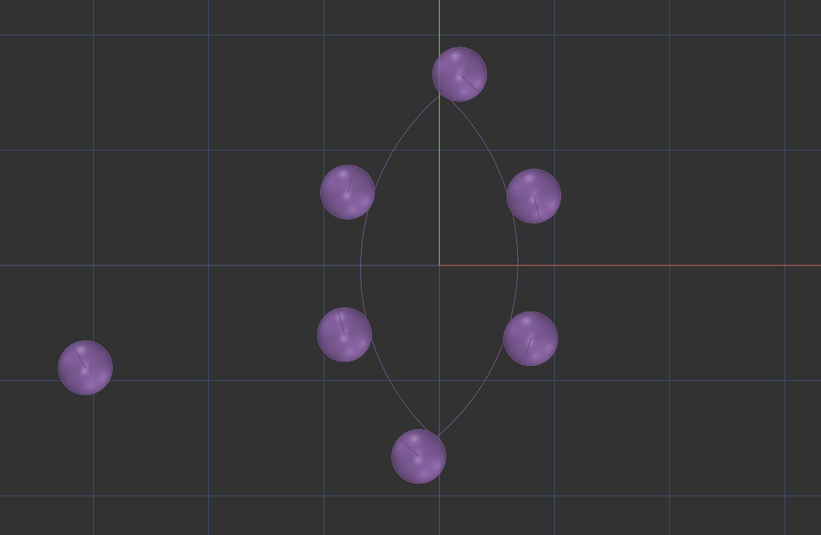

In the attached example, and in the screenshot from my actual file:
At certain values, a prong is missing…
In the example 3 and 6 are missing a prong, while all the other are correct…?
In my working file, also 7 is missing one.
There’s likely a better way to feed these parameters into the Prongs node [ Peacock ] But this what I managed to figure out, and it seems it should work…? [works partly]

Try like this:
2023-07-17 23_24_16-Grasshopper - Missing Prong_
For simple tasks like this one, where you just want to get sequential lengths, try to avoid custom components and use default grasshopper ones instead.

Yes, adding a 0 to the list solves the missing prong [in the configuration where it is missing.
Only issue here is that it needs to be turned off for the configurations that show correctly without it, I added a -1 to the slider for manual control… but it would be great if there was a way for this to automatically work correctly in all configurations…?
Please see in the [slightly ] expanded example file. These prongs, ideally, needs to fit in all the different gems cuts [shapes]
Another things I’ll need to figure out is how to offset the prongs, in configurations where they are not in the correct location [example below] I think I know how to do this manually… for each configuration. But I wonder if there’s a way to do this automatically?

Your solution works great, but it took away the control over the number of prongs!
which is essential .
I tried using a Polygon component instead of the Hexagon, but it only works correctly with even numbers.
And it has an issue with the center location of the prongs determined by the seam and not the centroid

This component was developed for Rhino 5 and it still working fine in there:
On RH7 you can try to fillet the girdle curve or some kind of trick like this to avoid the discontinuity.
Shatter Variable is to be used with multiple input lengths. To fix the missing part issue in RH7, you can multiply the curve lengh by 0.999.
Thank a lot @Dani_Abalde
This works perfect with some of the gem shapes, however I get placement errors with quite a few shapes: #1 , 2 , 4 , 7 ,10 ,12 , 13 ,14
I used the Expression 1/x for the Series perhaps this is incorrect?
Some example below: [I did try different prongs numbers, and some shapes do get resolved at a certain number, and some don’t in any combination…]

The prong locations are the actual curve parameters, so if you rebuild the girdle curve you make sure the curve parametric space is regular.
That’s correct.
Thank you so much
with Rebuilding the girdle curves, prongs are now placed correctly in all the gem cuts.
Learned a lot from this thread and all the help given.
