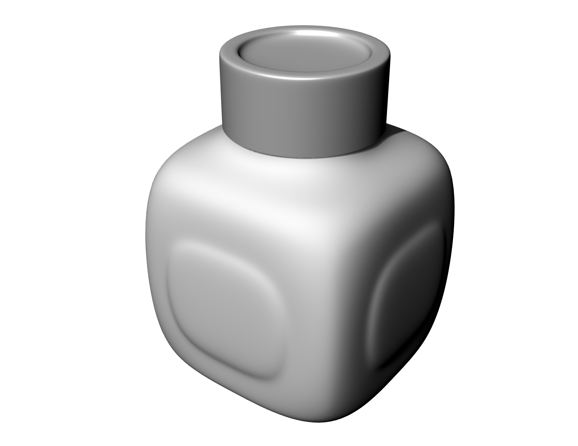

A honey container with SubD
add some thickness with offsetsubd and render it up, Looks like a nice start to a lovely little project!
Yes, sir
Thickness gives it a better view
I wanted to convert it into nurbs but a lot of lines (seam) was created.

I examined it on a cube after I converted it from SubD into nurbs. The result was excellent
