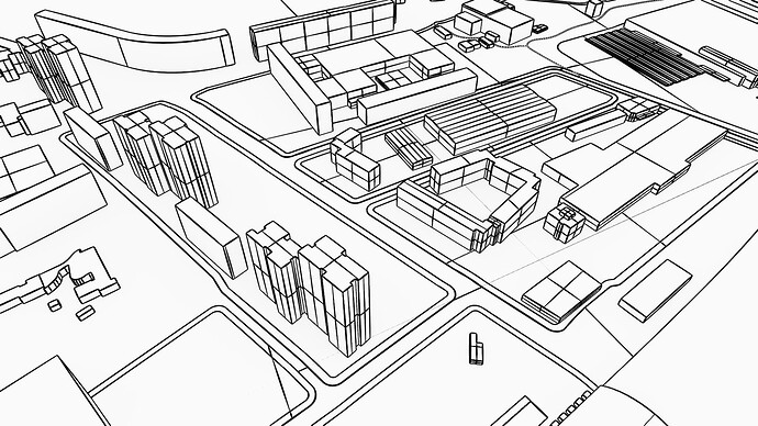

I’ve been playing with the showfancycurves command a bit for visuals more than sketching, and I think it has a lot of potential. I would be interested in seeing an option to hide the isocurves. They are disabled in the view itself but still show on most all brep objects.
Excited to see this tool develop further!
this command has evolved and simplified a bit- the most likely path forward is with the command
TestDisplayModeTaper
testfancycurves will likely be removed in the near future for a number of technical reasons the most of which are some significant problems it causes elsewhere in the pipeline. Thus is the way of test commands…
please try the new version and let us know what you think.

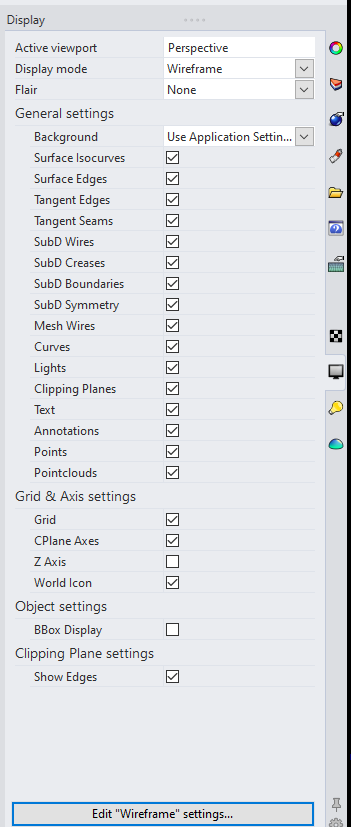

hey max can you screen shot this panel on your system?
It’s appears you have iso’s turned on…
Keep in mind too, testfancycurves only works on CURVES… not edges or iso’s… you’d have to dupe edges of that scene to get curves to see any effect.
make sure you are in the display mode you want to work with-

I’m not getting any taper effect in neither testfancycurves nor testobjectlinetype - or I’m doing something wrong. As you can see, I’m getting the halo effect and gradient works as well, but the taper eludes me :face_with_raised_eyebrow: Tried enabling PrintDisplay, but still no taper effect. Sysinfo below

PrintDisplay isn’t part of this. Your display mode probably is.
In this picture, the left one is in Shaded mode, the right one in Wireframe
I’m poking a developer for personal enlightenment…
These test commands are going away. They are causing more confusion than they are worth. We are adding controls to linetypes in Rhino so you can give each linetype a different thickness (either a single thickness or a taper thickness). Display modes are also being updated to use these thicknesses from objects.
