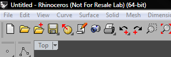

It’s still there in mine (NFR)…
here, too.
This IS the 64bit:
Hmm.
Hmm indeed, I changed mine into German and 64 is still there, so it’s not an error in translation either…
–Mitch
