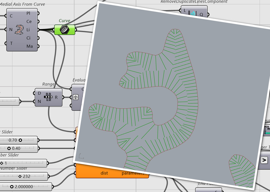

For one of my project I continue to work on Medial Axis. And for answering @ore
> [@Get skeleton more organic](https://discourse.mcneel.com/t/get-skeleton-more-organic/148278/25):
> @laurent_delrieu Sounds interesting! Any timeframe for the release? I would appreciate if you could notify my once it is available…
here is a component I will include in my plugin (partially free)
Medial Axis From Curve
 ![image](https://global.discourse-cdn.com/mcneel/uploads/default/original/4X/2/f/7/2f7140873ec4e64cb38bd112b9eb84cf4dc2ca57.jpeg)
Curve must be planar and closed. No hole at the moment
it will output the lines from the border

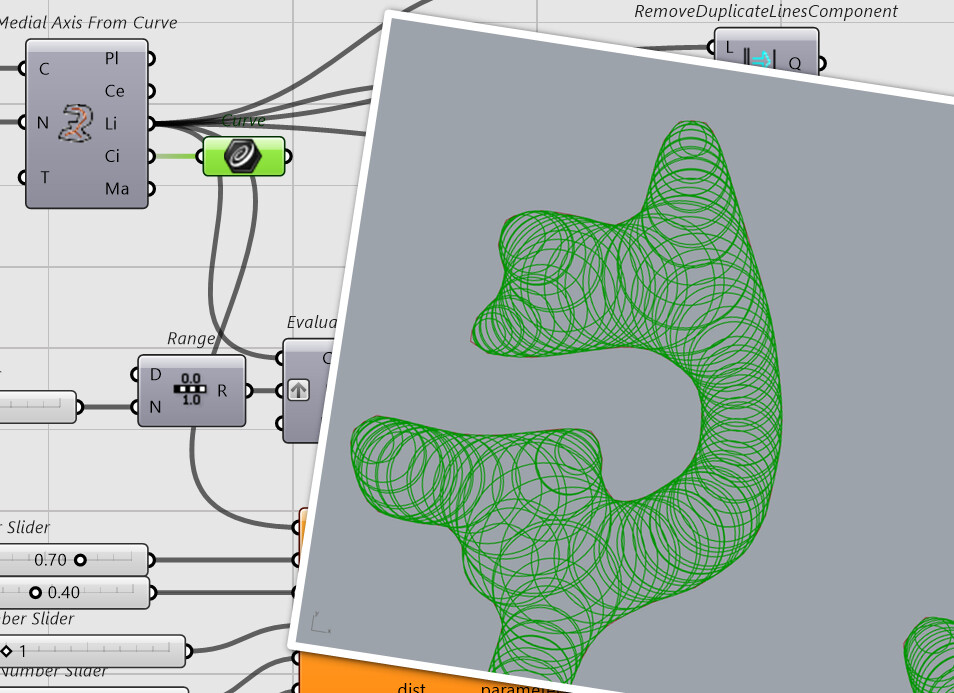

 ![image](https://global.discourse-cdn.com/mcneel/uploads/default/original/4X/0/c/9/0c97eeb6777e55a8ab930a6b75a0adf61e087dcb.jpeg)
The circles that approximate the shape (useful to use cloud points algorithms)
 ![image](https://global.discourse-cdn.com/mcneel/uploads/default/original/4X/7/7/a/77a337bbc8ce95ddfdef903b532c4b90d6ff17c4.jpeg)
And the medial axis with one polyline between each node
 ![image](https://global.discourse-cdn.com/mcneel/uploads/default/original/4X/9/e/4/9e48da0efc7667d3fbf48ca4077510a0e96949df.png)
The lines are ordered so it will be possible to make sort tweens curve of one closed curve
 ![image](https://global.discourse-cdn.com/mcneel/uploads/default/original/4X/b/5/5/b55bfb9a2ac8c09f44ea1ce83c66616fde9b5a89.png)

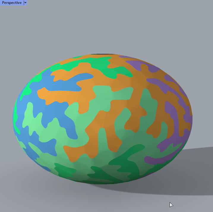

I use that to put some circles inside the shape
 ![image](https://global.discourse-cdn.com/mcneel/uploads/default/original/4X/3/7/0/3707492622fed921489a4e5801486df517842750.png)
