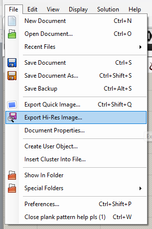

Instead of two images of your code, are you aware of this feature to “Export Hi-Res Image”?

I am aware, could not find it. Will use that. (Goes the same for “faint” in stead of “hidden” for Wire Display, as I read short time ago in one of your comments). Thanks.

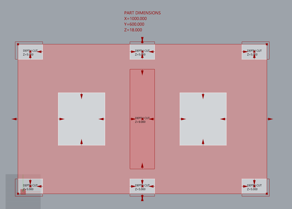

In addition to this being the dxf input I assume this might be part of the instructions for the machine operator. If so, I think you are underestimating what you can do with grasshopper. I added some parametric text to plant some ideas. It would be very easy to automate this to be much more useful, and output a CAD file in Rhino. Text tags will not work for that, but there are other options. If you want low tech you can print a .pdf file of your custom preview screen.

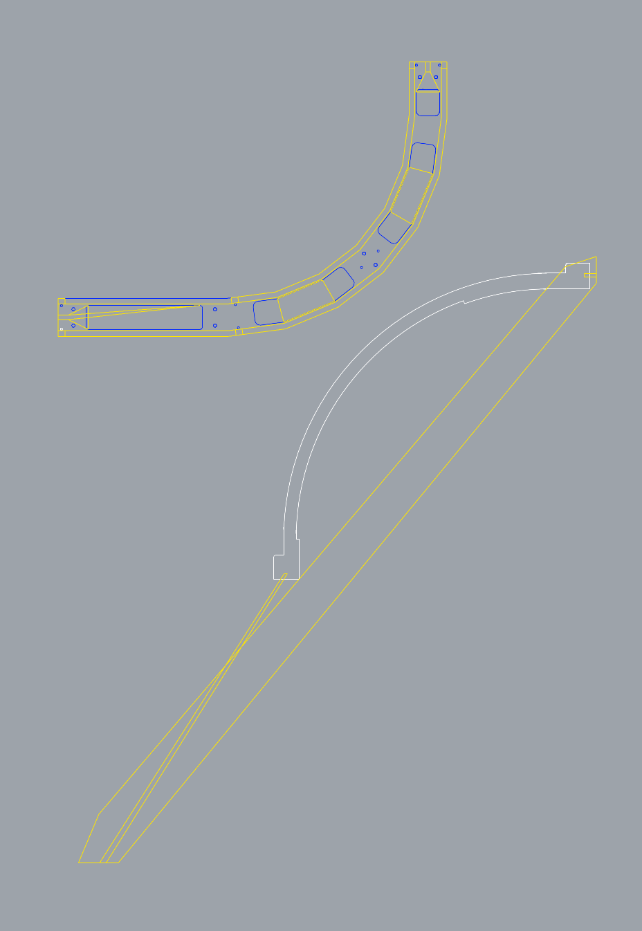

I’ve collected a few pieces that are fairly representative of what we machine in the workshop most of the time. Your definition works pretty well on less complex parts, but on curved parts it doesn’t work. Do you have any idea why?
PARTS.3dm (6.2 MB)

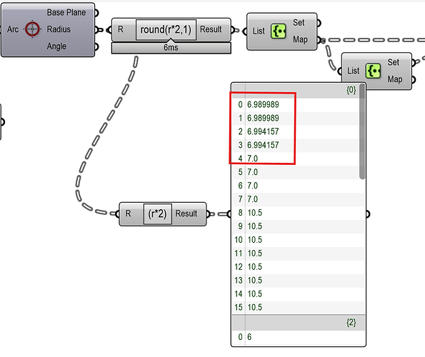

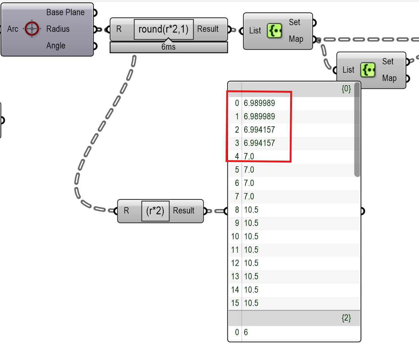

I found the diameter of some of your circles were out a little. I assume this is a simple error that is common, so I am rounding this in the script I am working on when time permits. It has some interesting steps to organize the data. I will share at some point.

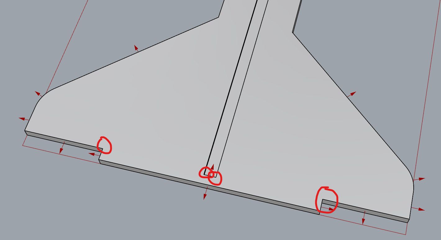

I have had a fast look to the new, more complex, parts you have posted
the following is not valid anymore :slight_smile:

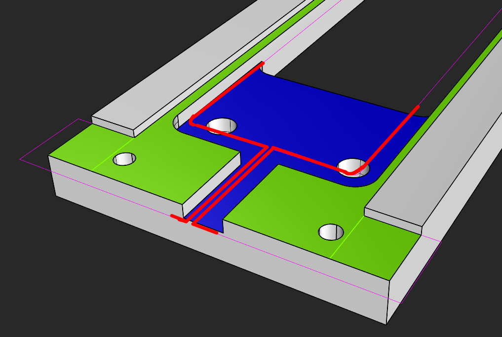

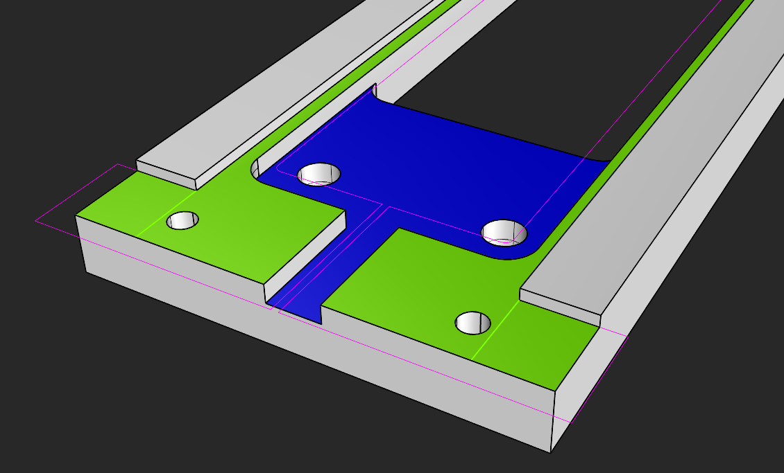

with parts showing pockets at several different heights, like this random one:
in order for the offset (magenta) to be allowed, the original (green) surface edge could lay on the edge of the bottom face but also on the edge of any pocket deeper than the green one (for instance here, all the inside curves overlapping the blue part can also exist, despite not falling over an edge of the bottom face)
I mean this portion of curves I have highlighted in red, that wouldn’t exist if we were comparing the green surface only to the bottom one:
all in all this is an interesting problem where I think a lot of problem solving and weird out of the box thoughts can be applied :smiley: I’m gonna have some fun with it :slight_smile:
I have this thought of this being a sort of entirely 2D problem, probably some Region Union might be involved at a certain point: the 3D structure of the Brep is relevant just on the very first steps of the definition, where you really need to retrieve a data tree listing all the horizontal surfaces of the Brep branched by Z-coordinate
after that it’s just a matter of comparing stuff

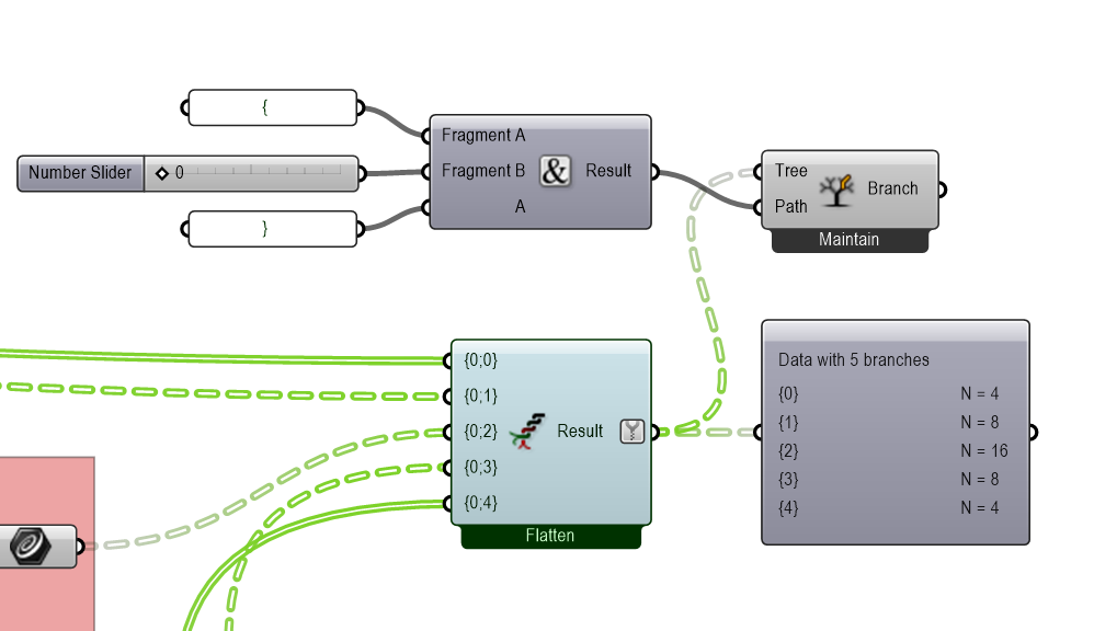

the interesting thing is, let’s say a given brep is represented by this data tree:
{0;0} (bottom face/faces)
{0;1} (lower pocket/pockets)
{0;2} (higher pocket/pockets)
{0;3} (top face/faces)
half of the job is already done :smiley:
you just need to find a reliable way to offset all the portion of curves of {0;2} (higher pockets) that lie on any boundary-edge of either {0:1} (lower pockets) or {0;0} (bottom faces)

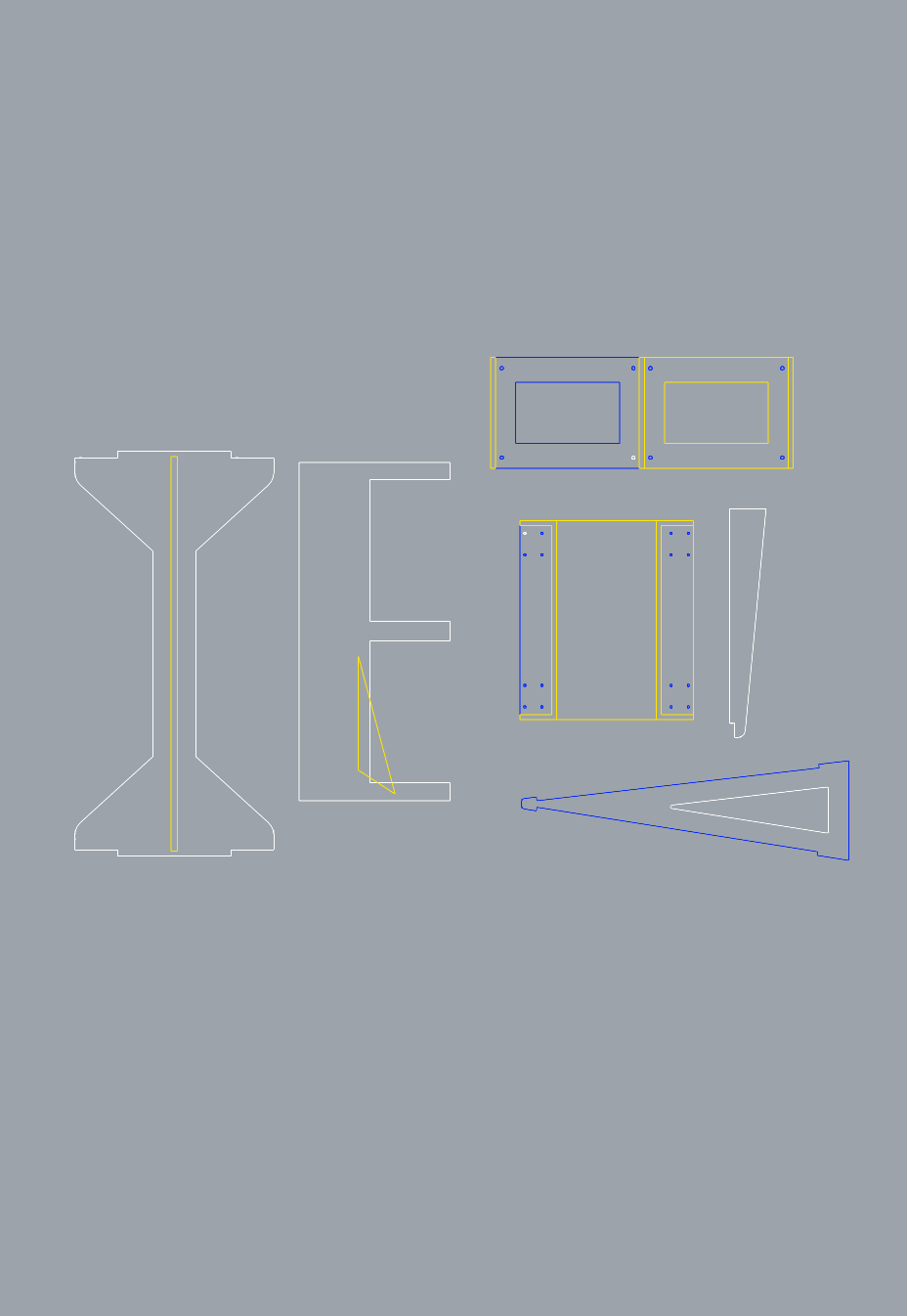

I worked on this project for a few hours yesterday. Mainly out of interest to see if I could improve my skills grouping the data. My approach is to look at the bottom plane and top planes separtely. I have only looked at the bottom plane in the script below. I split the problem into boundaries, thru pockets, and holes.
PARTS-brad.3dm (2.7 MB)
PARTS-brad.gh (53.6 KB)

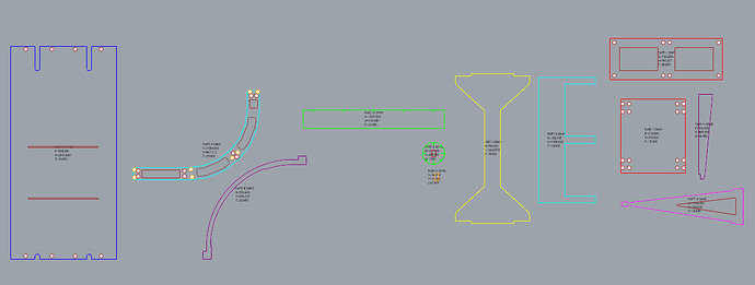

I decided to try to work with all the parts in your file at the same time. This was only done to improve my own skills with this amount of data. Obviously, working with one part at a time would be easier; however, I found it was not that difficult except for a few steps that took some time searching to find a solution. One could group the parts based on thickness quite easily if you are working with mutliple thicknesses at one time.

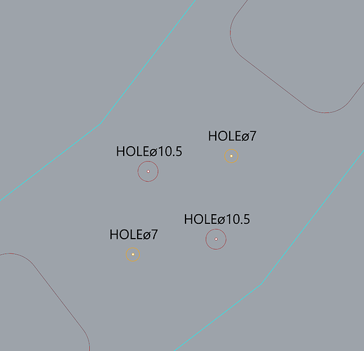

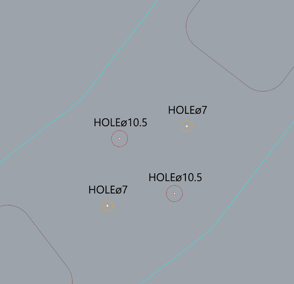

When I used VCarve I found the most tedious task was grouping all the holes for drilling operations. It was very easy to miss holes or select a hole that was the incorrect size. I decided to let GH solve that problem by grouping all the holes for each part. I also added some text in gh showing the hole sizes.

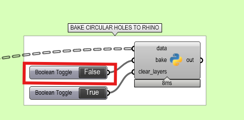

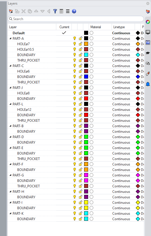

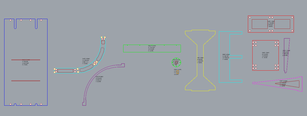

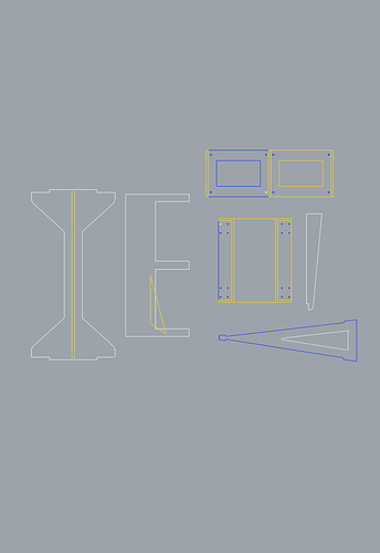

The next problem was baking the geometry into rhino. This seems like another step where humans could make mistakes. I had AI help me write a script to map the parts into unique layers based on the geometry and sub-layer names I added to the output data. I am not a wizard at python scripting, so someone with more skills could likely make that code more robust or look at options so one script could be used for all cases. I tried to randomize the colors of the layers, but it is not working quite like I want. One could go one step farther with this and add a small amount of code to automatically create the file your machinst needs. The part numbering and file naming scheme could be easily automated so the file name tells the operator a lot of information about the part. That is how it is done in the mechancial world. All of that will depend on your operation needs.
Bake Script:
Baked Geometry:
Rhino Layers from Script:
