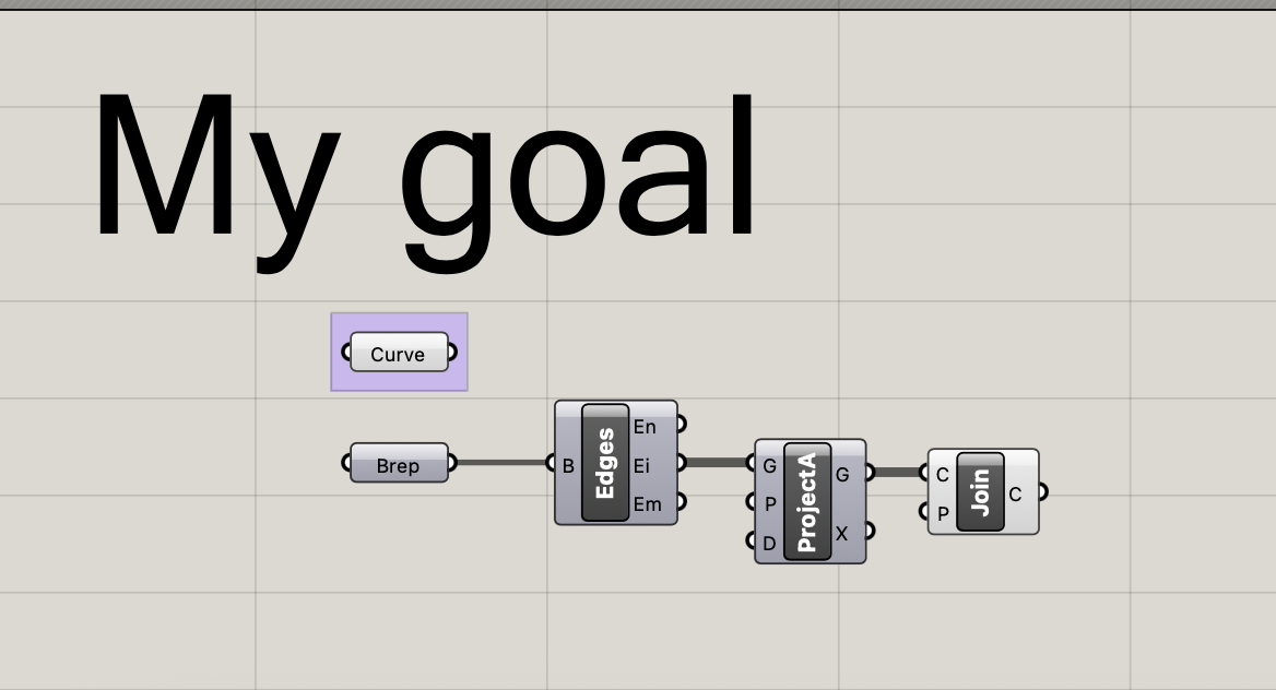

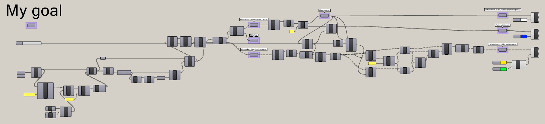

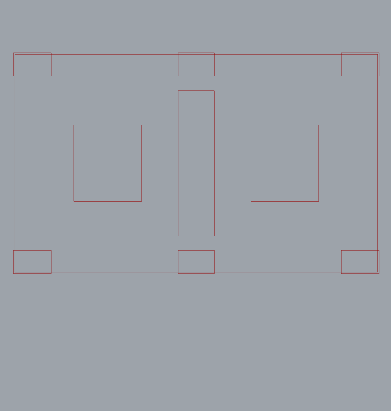

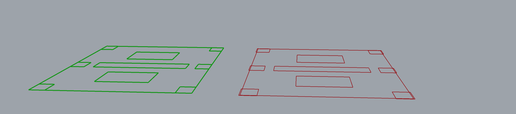

A little background:
In my company, we machine a lot of parts using CNC. Our machinist uses DXF files that we send him from the 3D volume. So we have to create these 2D DXF files (which takes a lot of time) that include all the cutting information (drilling, external cutting, internal cutting, pockets…).
Some time ago I created a python script that works most of the time, but we’d like to recreate it in grasshopper so we can use it directly in our other parametric models.
I’m not a grasshopper expert but I spent a few hours trying to create this definition (.gh link below). My aim is, from a part with cut-outs and pockets, to obtain a 2D curve of the underside (which gives me the outer contours + drillings) as well as the 2D curves of my pockets. I don’t need the top face curve (which I tried to do on my gh file). I need the curves to be projected flat on an XY plane.
Finally, I’ll need to offset all the pocket curves that overlap with the bottom face curve (image below). I need this small offset so that the router bit machines the pocket a little further than the outer cutout to get a clean finish. I haven’t come close to a solution on this point.
Any help is welcome!
Thank you,
 ![Base Brep](https://global.discourse-cdn.com/mcneel/uploads/default/original/4X/d/1/c/d1cd5cfe9e9c5d9c3353894fef6c110d56677786.jpeg)
 ![my goal](https://global.discourse-cdn.com/mcneel/uploads/default/original/4X/2/c/8/2c814379e1728232ad30aa823a54cd11333ada53.png)
[POCKET.gh](https://discourse.mcneel.com/uploads/short-url/pI5AAkHlALTzHjIWNIwWJtOPstD.gh) (69.8 KB)
Brice.

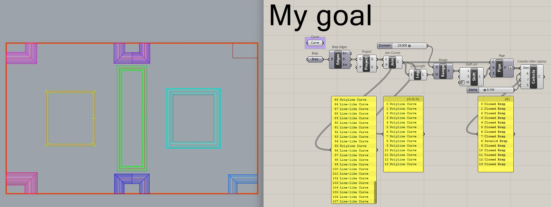

![Scherm­afbeelding 2025-06-30 om 23.15.19](https://global.discourse-cdn.com/mcneel/uploads/default/original/4X/8/c/9/8c98873dfa6e19dfaacf69ae4b3c7099ec1cc836.png)
Is this what you need?
 ![Scherm­afbeelding 2025-06-30 om 23.14.59](https://global.discourse-cdn.com/mcneel/uploads/default/original/4X/5/9/2/592bb86f6412394a44cd4f2831cd893b7cfd2344.png)
- Brep Edges gets all the edges out of your brep. (just as it says 🙂 )
- Project these on the XY plane
Erratum:
I did write
_- Join the curves to get rid of the duplicates._
Is not correct. It is more a cosmetic change. It looks like the duplicates are gone, but as @Joseph_Oster demonstrated, they are still there.
[POCKET\_EW.gh](https://discourse.mcneel.com/uploads/short-url/jJybBBSsvX6bINMQ2WJduTRbp5n.gh) (56.3 KB)

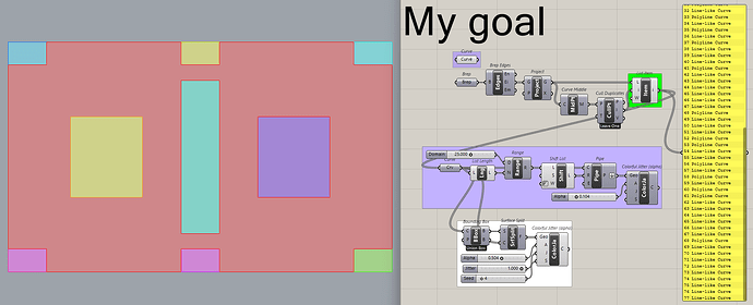

> [@Eef\_Weenink](#):

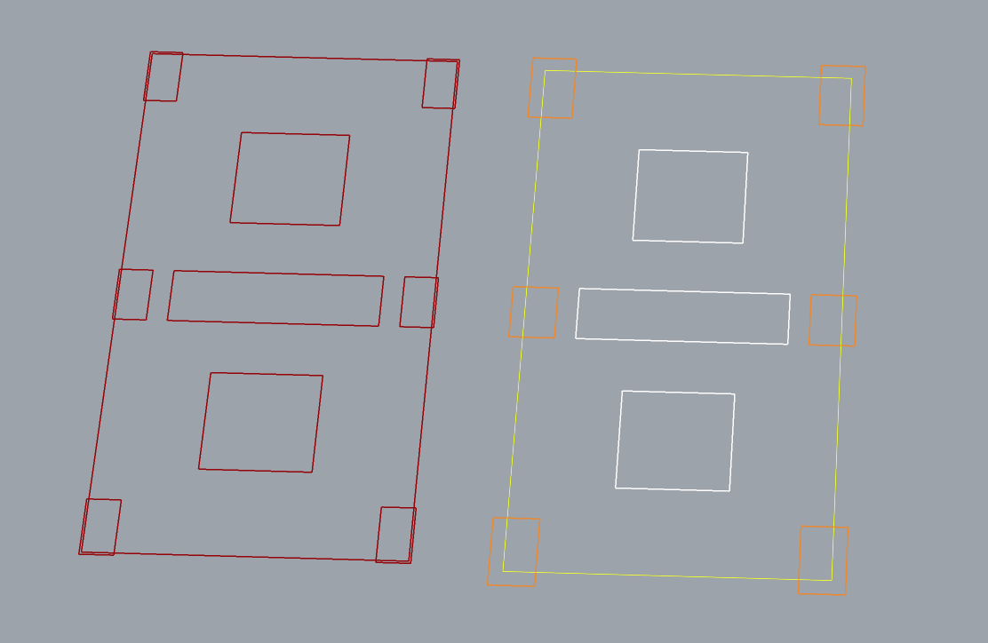

Join does no such thing ❗ Why Project Along instead of Project to a plane?
 ![missing](https://global.discourse-cdn.com/mcneel/uploads/default/original/4X/5/2/7/527d85e35ec1ac5904e484289fda37dcc9bd24d0.png)
This is not a solution, merely an illustration. The spec is poor.
 ![POCKET_JO](https://global.discourse-cdn.com/mcneel/uploads/default/original/4X/4/0/3/4037cc11610e95ee4a2399a326fc07d7daed1e1c.png)
[POCKET\_JO.gh](https://discourse.mcneel.com/uploads/short-url/rElkLEItcQJRv69X3LiZ3rqAHC2.gh) (40.7 KB)

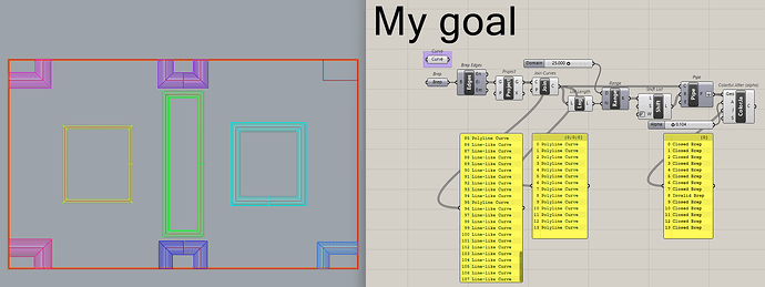

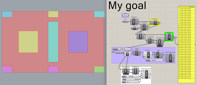

This purple group is copied from my previous post, with preview disabled on ColorJa.
It is not intended as a solution but reduces the number of projected edge curves from 108 to 78. The white group uses them to split a surface.
 ![POCKET_2025Jun30a](https://global.discourse-cdn.com/mcneel/uploads/default/original/4X/f/3/0/f30b680413da91a0e3964c9111759feca1ac4be0.png)
[POCKET\_2025Jun30a.gh](https://discourse.mcneel.com/uploads/short-url/8uO7t5Cp1GYC9SnwdelBYjKW8Bb.gh) (47.5 KB)

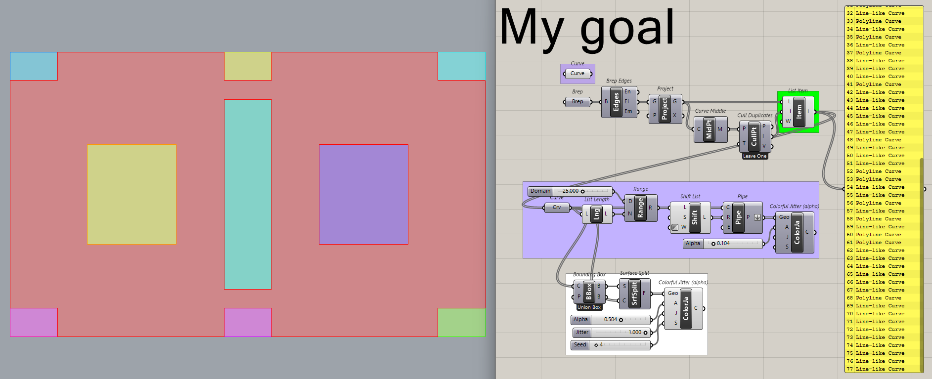

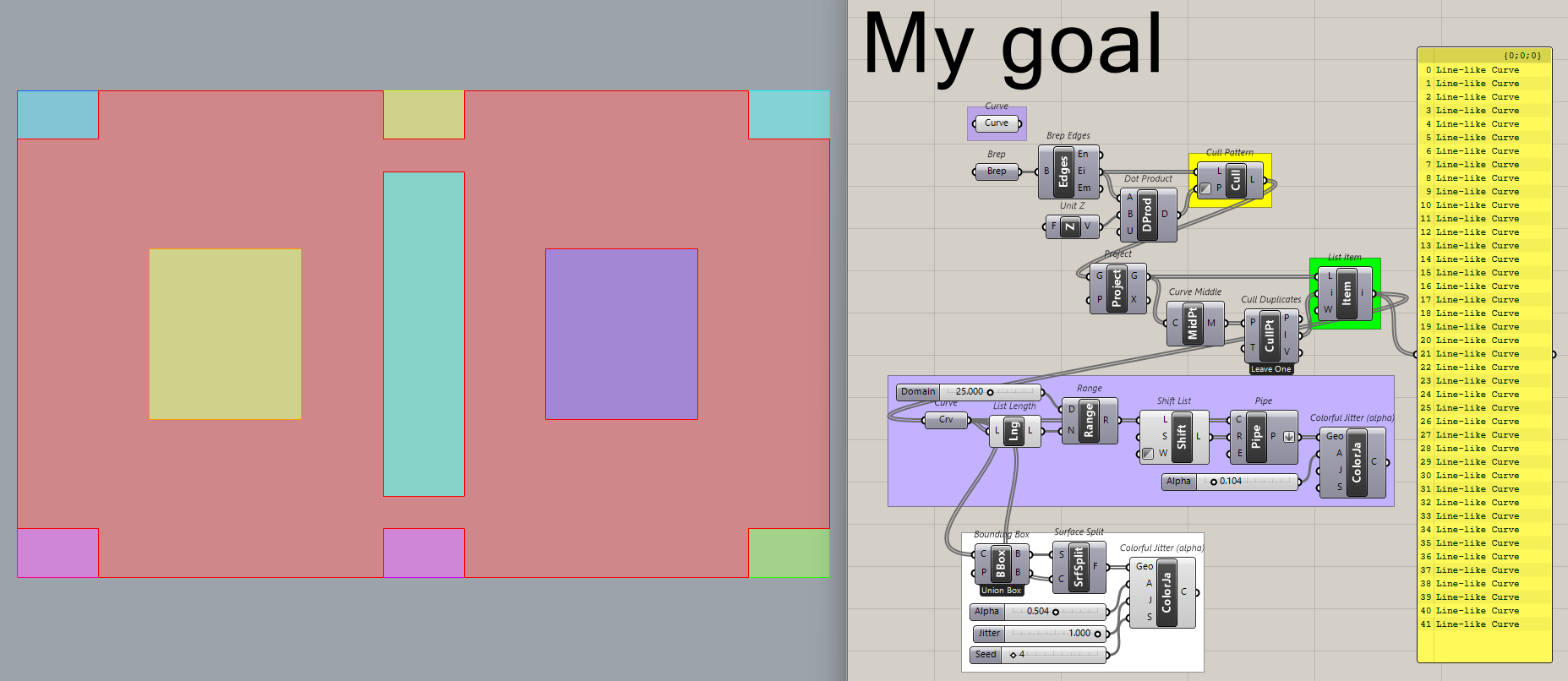

In this version, Cull Pattern _(yellow group)_ eliminates the vertical edges, reducing the projected edges further, from 78 to 42.
 ![POCKET_2025Jun30b](https://global.discourse-cdn.com/mcneel/uploads/default/original/4X/b/d/5/bd579ec53764b52665625058e41c74b48ee09148.png)
[POCKET\_2025Jun30b.gh](https://discourse.mcneel.com/uploads/short-url/ba18zYGHFQVKXnS2xFFtuRxFfiE.gh) (48.6 KB)
Dot Product might need to be rounded to work the edges that are not vertical?
**P.S.**
 ![POCKET_2025Jun30cc](https://global.discourse-cdn.com/mcneel/uploads/default/original/4X/4/e/0/4e0f32aacac32177dcf987de08471506703ee7bd.png)
[POCKET\_2025Jun30cc.gh](https://discourse.mcneel.com/uploads/short-url/dFPdJLvxGDcd0tKrCWgfedeXuqv.gh) (39.2 KB)

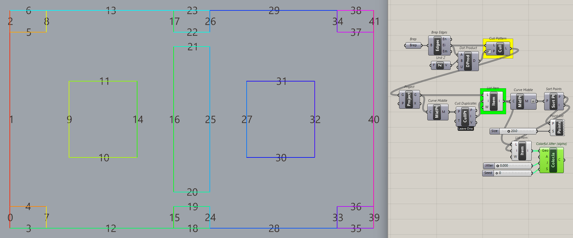

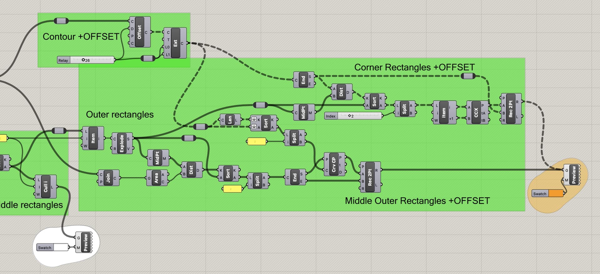

Let me give a second try to improve what I did.
- As you will see, a lot is done with:
- using midpoints of curves!
- get Z values, lengths, distances to “anchor points” you choose
then test/compare and select what you need.
A bit depending on how close next project of you are, it could be more automated (replace sliders with logic). But I think the approach is rather clear and easy to use as a starters for coming projects.
Regards, Eef
 ![Scherm­afbeelding 2025-07-01 om 13.50.32](https://global.discourse-cdn.com/mcneel/uploads/default/original/4X/3/5/7/357c86d2184af6e7d2cd1c902a4d0b2e51cce6be.png)
 ![Scherm­afbeelding 2025-07-01 om 13.43.03](https://global.discourse-cdn.com/mcneel/uploads/default/original/4X/9/6/1/9616cddfec6bbdd7e929ba27c7ccd920cdf67688.jpeg)
[POCKET\_EWII.gh](https://discourse.mcneel.com/uploads/short-url/fcOUPvDUuq1e1yELvue6pAsIF9N.gh) (77.9 KB)

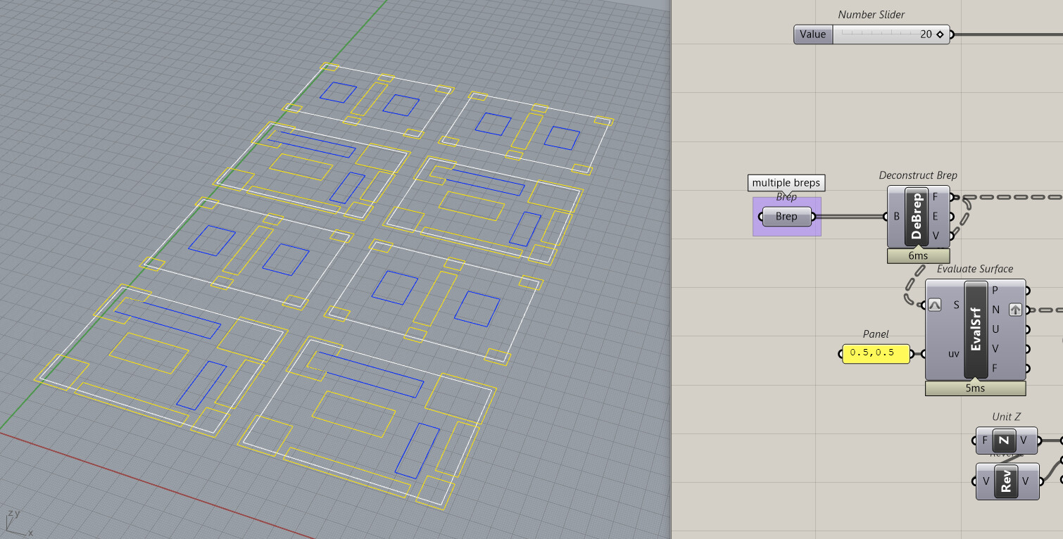

Thank you very much.
I’ve just tested your definition on several of our parts, there are sometimes a couple of errors. I’m going to collect several pieces and share them here.
On our simplest pieces it seems to work very well though! It’ll save us time already.
I’m wondering: do you think it would be possible to set multiple Breps instead of just one?
> Regards, Eef

> [@brice1](#):
yes for sure, but not in the state it currently is because I didn’t really put efforts and I violated all the rules of building a good definition 🙂 that was just a dirty sketch
if you collect many samples for which it fails, it would be much useful data 👍
[edit] @brice1 this version works (only) on multiple Breps (nothing else changed: it will still fail where the one-brep version was already failing)
 ![image](https://global.discourse-cdn.com/mcneel/uploads/default/original/4X/4/f/e/4fe4e8a57006c37b0981d08a533cbc5ceacfbcce.jpeg)
[POCKET\_inno\_multiple\_Breps.gh](https://discourse.mcneel.com/uploads/short-url/zdfyyHRXCOOupBqOqUEuzb3OHF8.gh) (27.4 KB)
