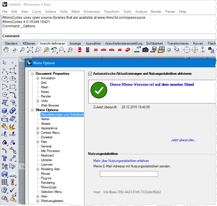

Rhino is set to German, but comes up in English/German mixed:
 ![](https://global.discourse-cdn.com/mcneel/uploads/default/original/3X/5/e/5e07f66114a1f32d7013aa29f60cdd013d767b71.png)

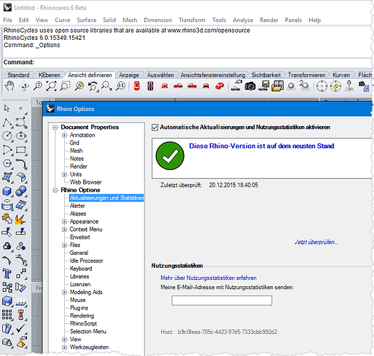

In the plug-in manager, right click on the Commands plug-in and look at the command list. Is Dot in there?
<div class="post-metadata">
**Author:** ![Charles](https://sea3.discourse-cdn.com/mcneel/user_avatar/discourse.mcneel.com/charles/32/747625_2.png) [@Charles](https://discourse.mcneel.com/u/Charles)\
**Post date:** [December 21, 2015, 10:47pm UTC](https://discourse.mcneel.com/t/-dot-unknown-command/27706/14 "2015-12-21T22:47:03Z")
</div>
No:
Couldn’t find \_Dot or Dot.
Yes:
 ![](https://global.discourse-cdn.com/mcneel/uploads/default/original/3X/a/6/a6c85dc7ba374d3ad1a873b4c194bd04c20d1840.png)

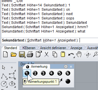

And ‘Anmerkungspunkt’ works:
 ![](https://global.discourse-cdn.com/mcneel/uploads/default/original/3X/d/4/d418655d0d4a771e5a90df3bfa4b90d60628b209.png)
But not \_Dot:
 ![](https://global.discourse-cdn.com/mcneel/uploads/default/original/3X/f/3/f34fe445732980149717e3296b7f2f1a6275680f.png)

Aha! that points me to what the problem is. I’ll try to get this fixed today
Thanks!
[http://mcneel.myjetbrains.com/youtrack/issue/RH-32422](http://mcneel.myjetbrains.com/youtrack/issue/RH-32422)
