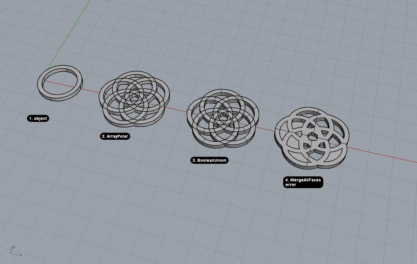

classic fail… you’d have to take a section and then extrude it to get what you want here.
Yes, this type of thing has also often happened to me… In this particular type of case, I usually array the circles and CurveBoolean into the pattern (if it’s not too much work) and then extrude solid. Or, Union all, then from Front view, I extract all the top and bottom surfaces via window select and delete them, then make 2 new planar surfaces (also window select edges from Front), then join. But it would be nice if MAF worked correctly, it does in V4.

While we are at that, something strange goes on in V4’s MergeAllFaces.
It works, but the resulting planar surface has control points very far away.
See attached.
The surface is a restult from V4.

I see that. I added it to the bug list to look into it.
