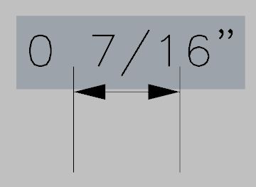

When you are creating a dimension where the text won’t fit between the extension lines you initially get something like this (if you’ve chosen to have the text above the line):

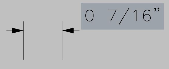

Moving the text to the right or left gives you this, with the arrows moving to the outside of the lines:

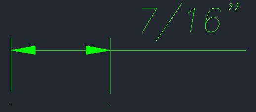

This is all good so far, except that our (ACAD) drafting standards specify that it should look like this:
What I can’t figure out, is how to make the arrows stay inside the lines, and in a perfect world, we would also be able to extend the dimension line out under the text. In the Properties dialog there is a button for "Arrows Inside always, but that doesn’t seem to have any effect.
Is this possible, and if not, could it be added to the wish list?

Hi Craig- yeah, as far as I can see at least these are feature requests… I"ll add your comments to the bug tracker.

  1. I agree that the arrows should stay inside the lines if you’ve chosen “Arrows inside always” but if you move the dimension up or down a little bit the arrows go back inside. They reverse direction when the dimension is in line with them.
