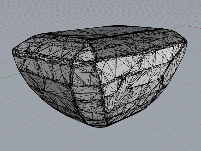

Where can I deactivate the polygon mesh in the shades view in order to work better with the stone?
Thanks
Roland
P.S. Sorry, I didn’t upload the picture correctly at the first topic.

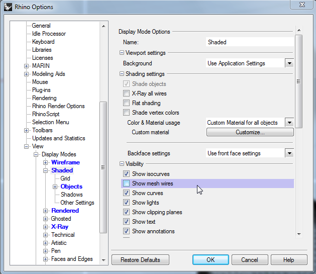

Either use the Rendered view (I’d say that’s the easy option) or go to Tools->Options.
Then uncheck “Show mesh wires” like so:
In options>view>display modes, in the “shaded” mode on the first page, uncheck “show mesh wires”. This can also be done via the display panel.

Are you shure this is a Mesh? it looks like the result from MeshToNurbs command.
C.

Your object appears to be a Nurbs object that was derived from a Mesh.
If that is the case, the _MergeAllFaces command might clean up you object as it merges all planar parts into one planar face.

It really is a MeshToNurbs object (I received an stl-file from the scan of the stone. In order to build a bezel setting around th stone I converted the mesh to a nurbs object).

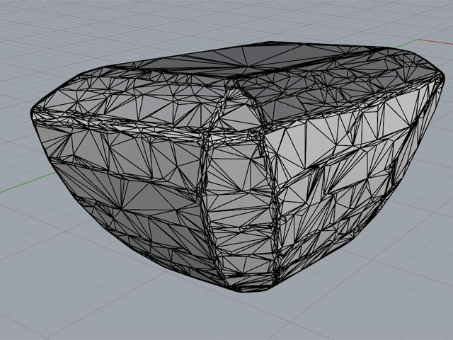

So the “pen” or “artistic” display didn’t change much. And with the MergeAllFaces command - I guess there are to many data - Rhino didn’t come to an end.
If I uncheck “show isocurves” in the shaded view some lines disappear but there are still lots of…
Is there maybe a better way to get started with my stl-file?

It really all depends on what you want to do.
If you want to work on this object (good luck), I guess you will want the edges to show. But it looks like a mess and it might be easier to model from scratch.
If you only want to display the object, you might be better off using a display mode that does not render the edges…
Why do you need this part as a Nurbs?
And can you use reduce mesh prior to nurbsifying it?
And if you post the STL here, then I am sure somebody will help you find a sollution.

You’re right - I don’t necessarily need to change my mesh wires in a nurbs object. I’m used to work with nurbs and - finishing a model - export it as stl-file. So working directly with the stl-file and unchecking the mesh wires solves my problem.
