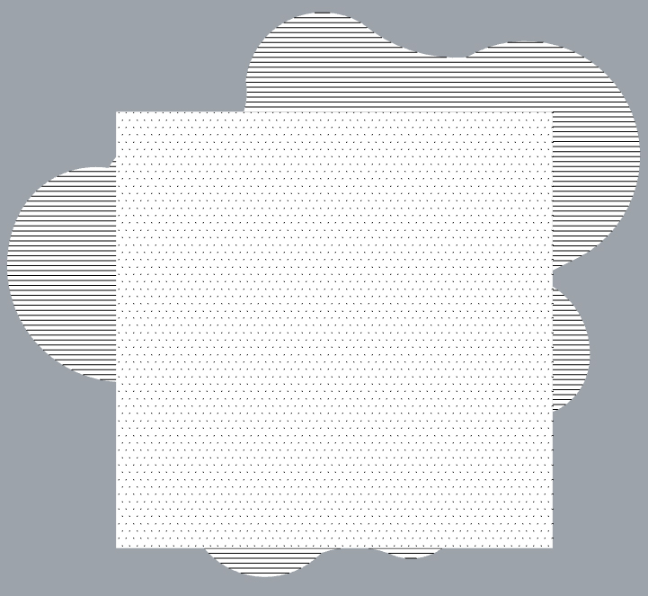

Ok, so I was able to recreate one very basic issue in a matter of seconds.
I think you don’t even need any example file (anyway it’s in the attachment)
Precisely: Try to use BringToFront command on the block (hatch A) so that this block is displayed in the front of another hatch(B). Impossible.
1808121330-draw_order_problem.3dm (36.6 KB)
Another one, this time no blocks involved.
A simple task - make this:
using two commands only: BringToFront and SendToBack,
within this file:
1808121950-draw_order_problem-2.3dm (44.2 KB)
Impossible.
Or am I doing something fundamentally wrong?
Hello - here, the dot hatch does not display at all. If I switch the hatches to ‘+’ I can manipulate them as needed, so far…
